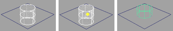

    A “trim grid” appears on the surface.
  3. Click the regions (defined by curves-on-surface) of the surface you want to keep (you do not need to hold Shift to click multiple regions).
    As you click, regions that will be trimmed away are dotted, and regions that will be kept are solid.
    If you want to change the tool so you click the parts of the surface you want to trim off, open the option box (Surfaces > Trim Tool > ) and set Selected State to Discard.
  4. Press Enter to trim.
