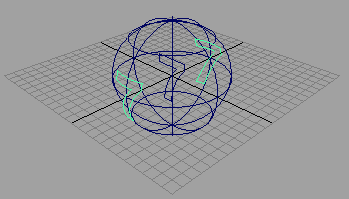

Maya provides several techniques for creating a curve-on-surface:
- Place edit points
- Project a curve onto a surface along the view direction
- Project a curve onto a surface along the surface's normals
- Intersect two surfaces to create a curves on surface
Draw a curve-on-surface by placing edit points
- Select the surface on which you want to draw a curve-on-surface.
- In the Status Line, click the “Make the selected object live” icon.
- Choose Create > CV Curve Tool or Create > EP Curve Tool.
- Draw a curve on the live surface.
- When the curve is finished, click the “Make selected object live” icon again.
- Select a surface and one or more curves.
Select the objects in a view pointing in the direction you want to project. For example, if you want to project along Y, select the objects in the Top view.
- Select >
and set Project Along to Active View. - Click Project.
Project a curve onto a surface along the surface’s normals
- Select
- Select two surfaces.
- Select Surfaces > Intersect.
The default is to create curves-on-surface on both surfaces. To only create curves-on-surface on the first or second surface, open the option box (Surfaces > Intersect Surfaces >
) and set the Create Curves For option.
