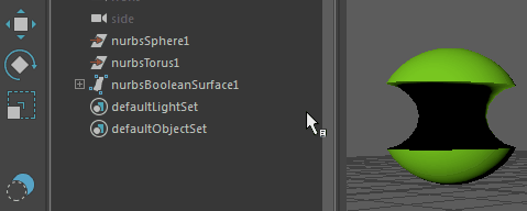

The order in which you click the surfaces only matters for the Difference tool. Maya subtracts the second surface you click from the first.
Sphere selected first
Torus selected first
Maya groups the combined surfaces.
