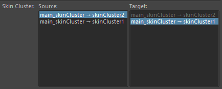

- Skin Cluster list
The Skin Cluster area lets you control individual skin clusters on geometry that has more than one skin cluster applied.
The Skin Cluster list contains a Source and Target column.
- Click geometry to update the list of skin clusters for the selected geometry, below.
- Skin Cluster list
- Skin clusters on the selected geometry appear here.
Note: If no skin cluster is selected this list remains empty. Select the geometry to update the list.
- The most recently added skin cluster appears at the top of the list.
- Source
- Select the skin cluster to be copied/mirrored.
- Target
- The skin cluster to which the copied/mirrored attributes apply.
