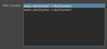

Skin Cluster
The Skin Cluster list contains all the skin clusters associated with the currently selected geometry
The Skin Cluster area lets you select individual skin clusters on geometry that have more than one or more skin cluster applied.
Skin Cluster list
Skin clusters on the selected geometry appear here.
Note: If no skin cluster are found this list remains empty. Select geometry to update the list.
The most recently added skin cluster appears at the top of the list.
