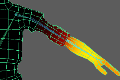

Heatmap falloff
Note: The Heatmap Falloff parameter appears only for the Heatmap bind method. The Closest in Hierarchy, and Closest Distance bind methods have a Dropoff parameter instead.
Controls the dropoff of weights around the selected joints when you select the Heatmap method of smooth skinning. This can help to reduce the amount of small weights spread across the mesh during heat map binding.
By default, Heatmap falloff is set to 0.68, which provides a better overall weighting. A value closer to 0 produces smooth results but can let small weights spread far across the mesh surface. A value closer to 1 produces a sharper falloff, which keeps weights closer to the influence object, limiting the spread of small weights.
In the following example, watch the character's elbow joint carefully to see the falloff change from a low setting of 0 to the highest value, 10. The higher the falloff value, the tighter the effect is constrained to the elbow joint.
This example uses the Paint Skin Weight Color Ramp to illustrate the effects of the bind. To try this yourself, see Use the Paint Skin Weights tool to test skin binding.

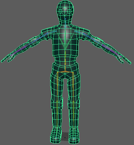

The following illustrations use the Paint Skin Weights tool to contrast low and a high dropoff settings, where the white area shows the strength of the bind influence. A low dropoff rate has very little influence over the skin and a high dropoff rate exerts much more power of the skin.
Mesh with a low Dropoff Rate (0.1)
Mesh with a high Dropoff Rate (10.0)
