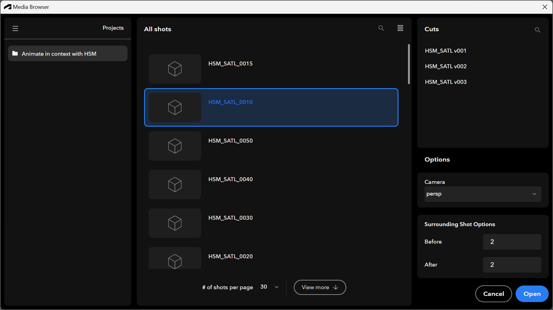

Load media with the Flow media browser
Use the Flow media browser to load a cut into Maya and animate in context.
There are three main areas of the browser:
Projects
These are projects you have access to. Typically, a project represents a single production.
Shots
The shots you can select to work on as the current shot.
Options
Once a shot is selected, you can view its information and set how you would like to review the shot in context of the cut.
Cuts
Name of the cut shared from Flow Production Tracking.
Camera
Defines the camera to align the before and after shots to in the current scene. You'll see the shot context in the Viewport only when looking through this camera.
Surrounding Shots Options
You can select the number of shots that precede and follow the selected shot in the cut using Before and After.
Note:
Media files are downloaded to the local system in the folder specified by the Flow desktop service's System Config and User Config.
