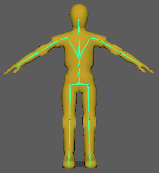

The bind pose is the pose that the skeleton is in when you bind skin and so it is the base (or rest) pose of your character. When you pose a character’s skeleton after skinning, the skeleton’s actions deform the skin. The only pose that does not cause deformations to the skin is the bind pose.
Character in its bind pose
If you bound skin to selected joints only, returning to the bind pose resets all the joints of the skeleton to the bind pose. Also note that the skeleton will go to the bind pose even if it is parented to group nodes.
You must return to the bind pose if you decide to bind additional objects.
