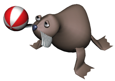

Skinning is the process of binding deformable objects to a skeleton. Typically, the deformable objects are NURBS or polygonal surfaces. These geometry objects become the character’s surface, or skin, and their shapes are influenced by the action of the skeleton’s joints.
