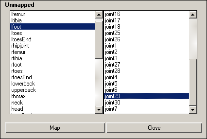

  6. Select one node or attribute from the left unmapped column, and select its corresponding node or attribute in the right column. For example, if the left ankle joint for your source character is lfoot and the left ankle joint of your target character is named joint29, then your selection would resemble the following:
  7. Click Map.
  8. Repeat steps 6 and 7 until you have mapped all the nodes or attributes from the source and target characters.
