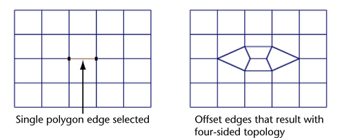

  4. Click an edge on the polygonal mesh where you want the new edge loops to be offset from on mesh.
    A pair of edge loop preview locator lines appear on either side of, and parallel to, the edge you clicked. The green dotted preview locators indicate where the edge loops will be inserted across the mesh once you release the mouse button.
  5. Continue to click edges along the same edge loop of the mesh to build the desired partial loop of selected edges on the mesh.
    The Offset Edge Loop Tool selects any edges between the first and last edge you select and updates the edge loop preview locator as you proceed.
    Tip: You do not have to click every edge along the path. Click once to specify the first edge and a second time along the same contour line of the mesh to indicate the end of the path.

Depending on the extent of your edge selection, the Offset Edge Loop Tool inserts edges in a more radial fashion compared to the original mesh, based on how the Offset Edge Loop Tool maintains the four-sided topology when the Delete Edge option is turned on. This radial detail can be useful for creating features such as an eye, ear, or a mouth on a model of a character.
