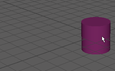

The Insert Edge Loop Tool (in the Modeling > Mesh Tools menu) lets you select and then split the polygon faces across either a full or partial edge ring on a polygonal mesh. It is useful when you want to add detail across a large area of a polygon mesh or when you want to insert edges along a user-defined path.

When you insert an edge loop, you are splitting the polygon faces associated with the selected edge ring. The Insert Edge Loop Tool lets you insert one or more edge loops across a full, partial, or multidirectional edge ring.

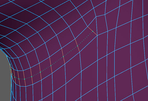

Dealing with partial or incomplete edge loops
Sometimes when you highlight certain areas of the model, the preview will only display a partial edge ring. If this is unexpected, then double-check the topology of your model. The new edge loop is determined by the existing quads on a mesh, so if there are any errant edges or vertices, they will interfere with the tool's ability to calculate a full edge loop.
In the example above, a tri stops the edge loop from forming all the way around the neck.
