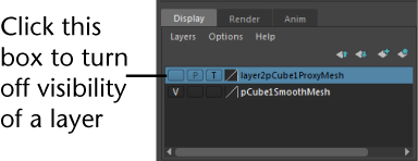

To hide a display layer
- In the
Display Layer Editor, click
V in the first column next to a layer name to toggle the visibility of objects on that layer.
To hide a display layer only during playback
- Click
P in the second column next to the layer name.
Objects on the layer remain visible in the scene view while you work, then turn invisible during playback.Note: Hiding display layers during playback is only available with Viewport 2.0. See About Viewport 2.0.
