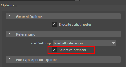

The Selective preload option in the Open Scene options opens the Preload Reference Editor

- In the
Open Scene Options,
Referencing options section, turn on
Selective Preload, then click
Open.

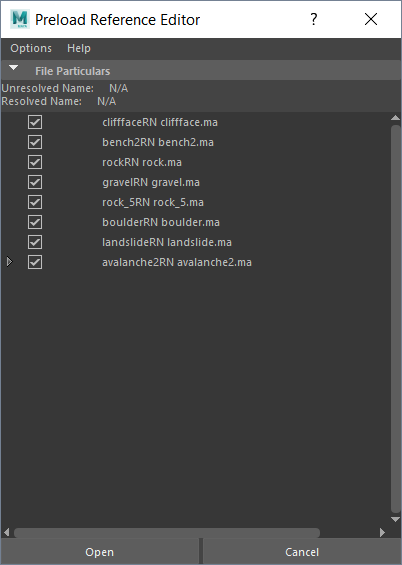

The Preload Reference Editor appears. The Preload Reference Editor lists all available file references for the scene. Depending on how the Referencing options were set, some file references will appear loaded or unloaded in the Preload Reference Editor. When an icon appears beside a particular file reference it indicates that one or more proxy references exist for that reference.

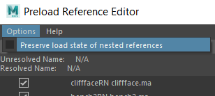

Note:You can set whether the load status of the parent reference affects the load status of the child references nested beneath with the Preserve load state of nested references option in the Options menu at the top of the editor. The default is off, and toggling the load status of a reference affects the load status of any child references within it.
- Select one or more items in the
Preload Reference Editor by doing one of the following:
- Click the check box next to a reference to indicate that you wish the reference to be loaded.
- Right-click an item and select Bring in Reference Loaded or Bring in Reference Unloaded from the menu that appears.
Set Active Proxy To from the menu that appears. When a file reference contains one or more proxy references, the
Set Active Proxy To option appears. Set
Active Proxy lets you select which proxy reference you want to load into the scene by displaying the list of available proxy references (by their proxy tags) in the
Set Active Proxy To
submenu.
Tip:
It is possible to set the load or active state for multiple proxies simultaneously when using the Preload Reference Editor. The list of proxy tags that appear in Set Active Proxy To submenu (when multiple file references are selected) is generated from all of the proxy tags currently in use for the proxy sets associated with the selected file references.
Turn on Preserve load state of nested references in the options menu
