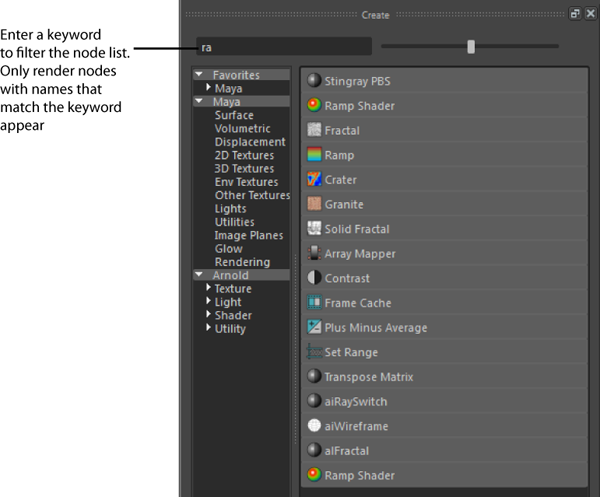

Searching for a render node
Enter the keyword for the render node that you want to create. As you enter a keyword, the right panel of the Create tab updates in real time and only render nodes with names that match what you entered are displayed.
You can also use the search area to clear your selection. When you select one or more sections, only the nodes in the selected sections are displayed in the right panel. To clear your selection, press Enter in the search area.
