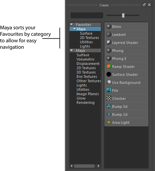

You can customize your Create tab by creating a list of favorites. This allows you to easily access your most commonly used shaders.
Creating favorites (Method 1)
  1. In the Hypershade, middle-drag the shader to Favorites in the Create tab to add a shader to your Favorites list.
Creating favorites (Method 2)
  1. In the Hypershade, right-click the shader and select Add to favorites.
The Hypershade sorts your favorites in categories to enable you to locate your shaders easily.
