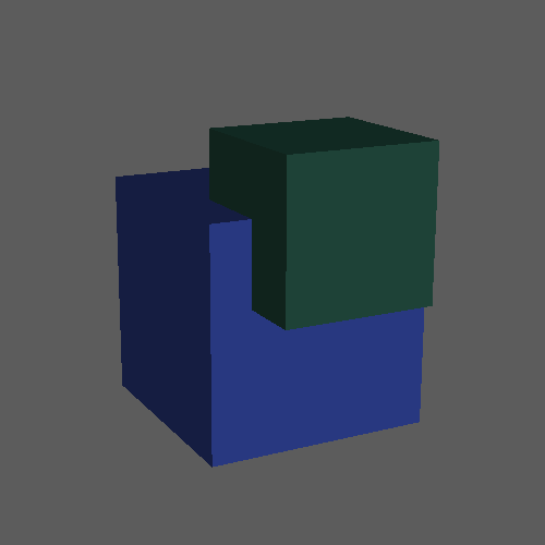

You can use the following boolean operations to create a new, complex shape.

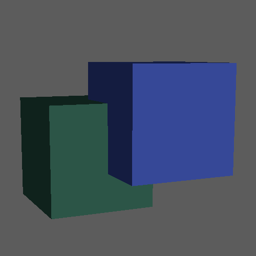

- Union
- Fuses objects together.

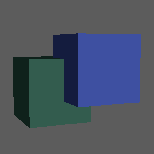

- Difference (A-B)
- Subtracts the second selected object (B) from the first selected object (A).

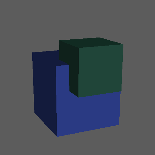

- Difference (B-A)
- Subtracts the first selected object (A) from the second selected object (B).

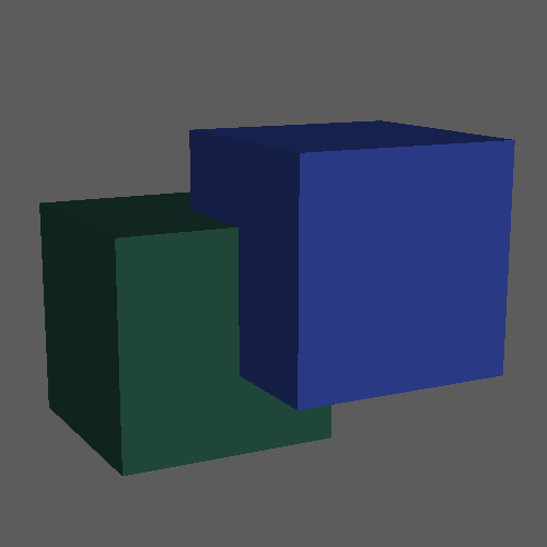

- Intersection
- Deletes any surface that is not inside another input object, fusing the remaining interior surfaces.

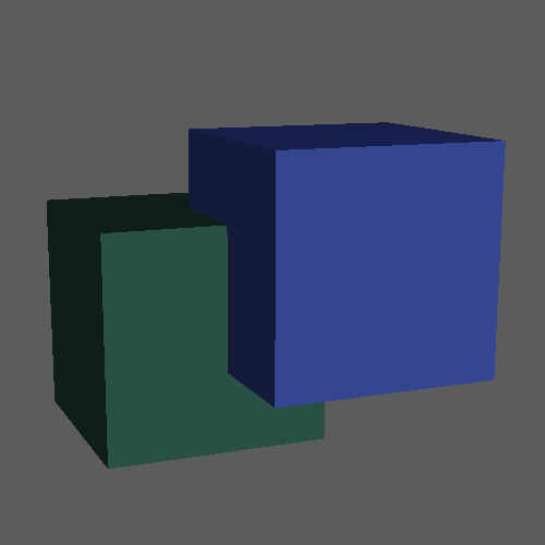

- Slice
- Divides the faces on the first selected object where the input objects intersect, creating separate shells.

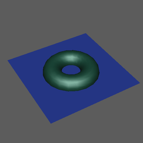

- Hole Punch
- Removes any surface of the first selected object that is inside any of the other input objects, leaving an open mesh.
- Cut Out
- Removes any surface of the first selected object that is outside any of the other input objects, leaving an open mesh.
- Split Edges
- Inserts new edges on the first selected mesh along the intersection of the input objects.
