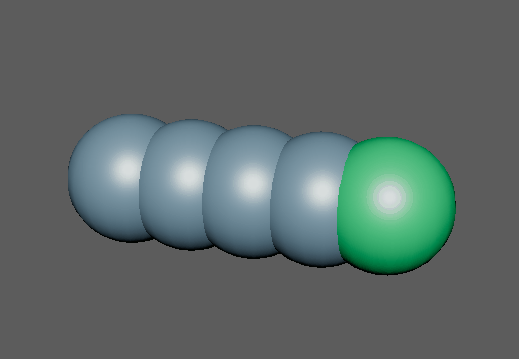

An error message appears in the Script Editor after performing an intersection operation. |
When you perform an intersection operation with input objects that don't intersect, the following error message appears in the
Script Editor and continually reappears as you work with your objects:
Error: Cannot perform boolean operation. For example, when you perform an intersection operation on the following list of objects, it returns an empty result and an error message:
![]() If you want to run an intersection on a list of objects, you can try the following:
when the Boolean stack is visible.
