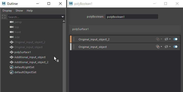

To add input objects to an existing boolean node using the Outliner
- (Optional) In the Boolean stack, select an operation from the
Operation for new inputs drop-down menu.
Your selection is applied to all new inputs. By default, new input objects are automatically assigned the Union boolean operation.
- Click
to pin the Boolean stack or click
Copy Tab to open the boolean node in a separate window.
- MMB-drag your objects from the
Outliner into an empty space in the Boolean stack.
