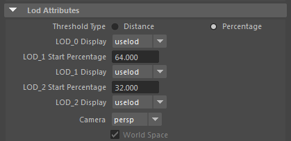

To view more than one object in the group at a time
- In the
Hypergraph or
Outliner, select the level of detail group node.
The LOD node attributes display in the Attribute Editor and Channel Box.
In the Attribute Editor, you can see the Lod attributes section lists an LODn Display option for each level, with a drop-down list containing three possible settings: uselod, show, and hide.
By default, all levels are set to uselod, which means geometry is switched out according to the group threshold values. - For each level that you want to preview, set the drop-down to
show.
- When you're ready to return to the regular level of detail behaviour (letting levels switch based on the threshold), reset all LODn Display attributes to uselod.
