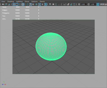

- In order, select the geometry you want to put in the LOD group.
Select the highest resolution model first, and the lowest resolution model last. By default, objects are assigned to the LOD level stack in the order you select them, so you want the highest resolution model to be ordered first.
For example, selecting (1) Sven_Body_HiRes, (2) Sven_Body_MedRes, then (3) Sven_Body_LowRes creates the following LOD group:
