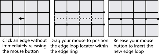

- Click the edge on the polygonal mesh where you want a set of new edges to be inserted across the mesh. Do not immediately release the mouse button.
Tip: To quickly insert an edge loop with edge flow, temporarily activate Insert with edge flow by holding Shift each time you click an edge where you want a set of new edges to be inserted across the mesh.
A green dotted edge loop preview locator line appears within the edge ring that is selected perpendicular to the edge you clicked. The edge loop preview locator indicates where the new edge loop will be inserted across the mesh once you release the mouse button.
- Depending on the orientation of the selected edge ring on the mesh, drag your mouse in either a side to side, or back and forth motion to position the edge loop preview locator.
- Release the mouse button when you have moved the edge loop locator to the desired location.
The new edge loop is inserted on the polygon faces associated with the selected edge ring. The new edge loop remains selected so that you can perform additional operations on the edges.
