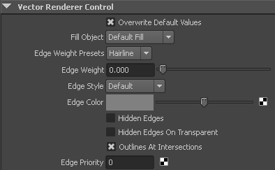

You can find these attributes in the Vector Renderer Control section in the Attribute Editor for the material node (for example, phong1).
To set vector rendering material attributes
- Select the object with the material for which you want to set vector rendering attributes.
- In the Attribute Editor, select the material node, (for example, blinn1).
- Open the Vector Renderer Control section.
- Turn on Overwrite Default Values.
- Adjust the attributes as required.
