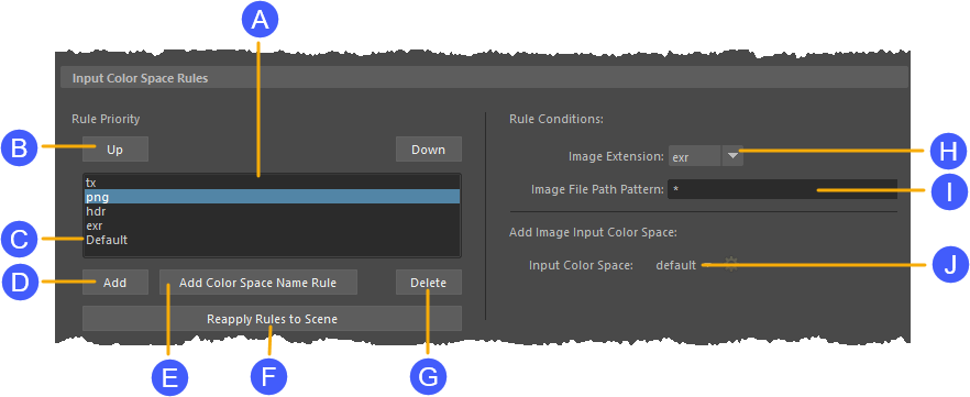

A. Rules list
Select a rule. You can edit the selected rule using the options on the right (H, I, J).
If you are using the default preferences, there are some preset rules in addition to the Default rule. The tx, hdr, and exr rules assign the input space of any file with those extensions to Raw. Unlike the Default rule, these are ordinary rules that have been added for convenience, and they can be edited, deleted, and moved up or down like any other rule.
B. Up, Down
Rules are applied in order from top to bottom. The input space specified by the first rule that matches is initially set as an image's Color Space attribute. Use the Up and Down buttons to move the selected rule.
C. Default rule
The input space specified by the Default rule is used when no other rule matches. You can only specify the input color space — you cannot specify a condition to match. The Default rule is always the last in the list and cannot be moved.
In the configuration files installed with Maya, the Default rule assigns textures to the default role — this is an alias that resolves to sRGB Encoded Rec.709 (sRGB) in those configurations.
D. Add
Add a new rule to the top of the list.
E. Add Color Space Name Rule
Adds a special rule called ColorSpaceNamePathSearch. This rule is similar to the rule for assigning input spaces in OCIO v1. It assigns each texture file to the longest color-space name found anywhere in the file path. Note that matches are not case-sensitive.
F. Reapply Rules to Scene
Reapplies the rules to change the Color Space attributes of existing image nodes in the scene. Image nodes with Ignore Color Space Input Rules checked on are not affected.
G. Delete
Delete the selected rule. The Default rule cannot be deleted.
H. Image Extension
Specify the file extension to match in the selected rule, or use * for any extension. File extensions are not case-sensitive.
I. Image File Path Pattern
Specify the pattern for the selected rule to match in the full path of an image file. Strings are case-sensitive, and use the so-called "glob" syntax for pattern matching.
String Pattern Example
? Any one character. ?pecular matches specular and Specular, as well as Xpecular and many others.
* Zero or more characters. *diffuse matches diffuse at the end of the path.
diffuse* matches diffuse at the beginning of the path.
*diffuse* matches diffuse anywhere in the path.
Tip: Put an asterisk at the beginning of every pattern so that image files get matched in any directory.
[chars] Any one of the specified characters. *[nN]ormal* matches normal or Normal anywhere in the path.
[char1-char2] Any character in the range. *[0-9] matches any path ending with a numeral.
[!chars_or_range] Any character except those specified. *[!0-9] matches any path that does not end with a numeral.
/ Escapes the next character, that is, treats the next character as a literal, instead of part of the pattern matching syntax. */[*/]* matches a pair of square brackets anywhere in the path.
J. Input Color Space
Select the color space to assign to files that match the selected rule. For a description of the spaces that are available in the configurations installed with Maya, see List of input color spaces.
