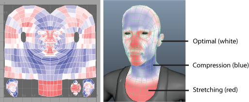

The distortion shader lets you easily pinpoint UVs that are stretched or compressed. Color feedback lets you visualize distortion errors: red faces indicate stretching, blue faces indicate compression, and white faces indicate optimal UVs.

The distortion shader is applied to your UV mesh and appears in the UV Editor.Note: If the distortion shader doesn't appear on your mesh, ensure that Viewport 2.0 is selected in the Renderer panel menu.
Areas of distortion are shaded relative to the texture area in UV space.
