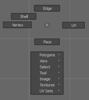

To select UVs and UV shell components in the UV Editor
  1. Right-click in the UV Editor's 2D view and select a component mode from the marking menu.
    Tip: Press f in the UV Editor to frame any selected items in the 2D view.
  2. Select components in the 2D view.
