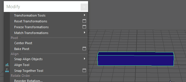

To reset the selected object's pivot to center
- Select a transform tool.
- Select
Modify > Center Pivot.
The pivot moves to the center of the object's bounding box.
Tip: There is no hotkey for centering the pivot. However, you can add a Center Pivot option to the shelf by doing the following:While holding Shift + Ctrl, open the Modify menu, locate Center Pivot and release the mouse over the Center Pivot option. A CP icon appears at far right of the currently active shelf.
