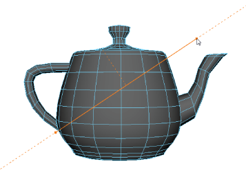

Multi-Cut Tool
The Multi-Cut tool cuts, slices, and inserts edge loops. You can extract or delete edges along a cut, insert edge loops and cuts with edge flow and subdivisions, and edit in Smooth Mesh Preview mode.
You can access the Multi-Cut Tool via:
  • The Tools section of the Modeling Toolkit window, and clicking .
  • The main menu bar, by selecting Mesh Tools > Multi-Cut.
  • The marking menu, by selecting Multi-Cut Tool (to open the marking menu, Shift + right-click when an object, edge, or face is selected).
For more information on how to use the tool, see the related topics.
