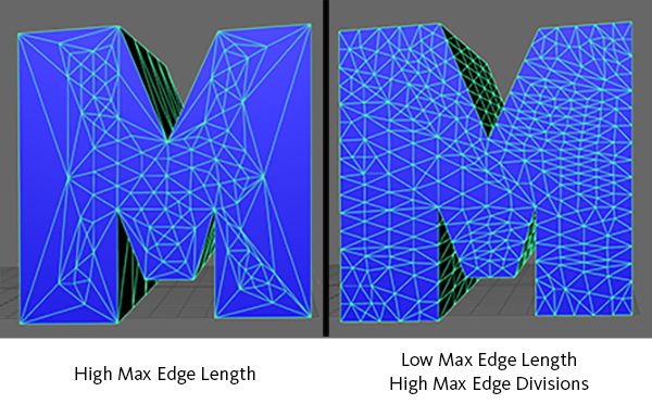

- Max Edge Divisions
Specifies the maximum number of times an edge can be divided by vertices. Default value is 20.
- Max Edge Length
Splits all edges along the profile of the type mesh that are longer than the length specified here in world units. Default value is 5.

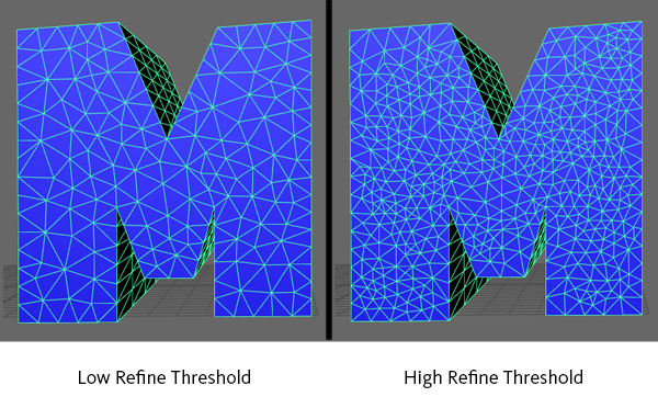

- Refine Threshold
Splits all edges on the front and back faces of the Type mesh that are longer than the length specified here in world units. Mainly used to control the density of the cap subdivisions. Default value is 1.

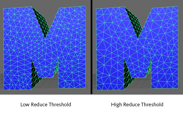

- Reduce Threshold
Collapses all edges shorter than the percentage of the Refine Threshold value specified here. Mainly used to clean up the cap subdivisions. Default value is 20.
