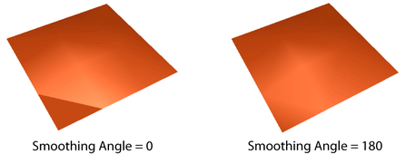

Cut/Insert Edge Loop Tool
- Smoothing Angle
- Specifies whether or not the inserted edges are automatically softened or hardened when an operation is complete. When
Smoothing Angle is set to 180 (default), the inserted edges appear soft. When
Smoothing Angle is set to 0, the inserted edges appear hard.
Note: You cannot see the effect of the Smoothing Angle in the scene. - Edge Flow
