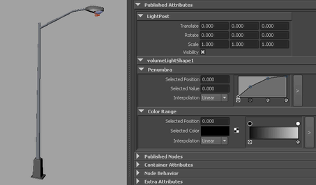

Published attributes appear in the Attribute Editor in the Published Attributes section or at the top of the Channel Box under the asset they are published to.

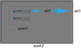

If the selected object is stored in a hierarchy of assets, all the assets above it appear in the menu. However, you can only publish attributes to higher level assets if they are also published to intermediate level assets.
For example, in the case below you can publish pCylinder1’s att1 to asset2 since it is published to asset1. On the other hand, you cannot publish any of pSphere1’s attributes to asset2.
