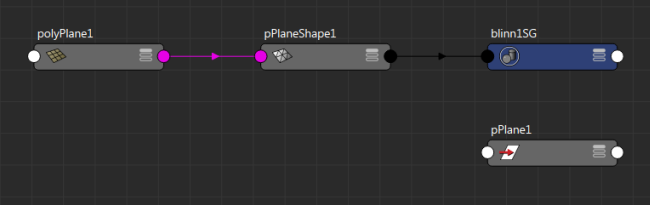

  1. Select your object, and click in the Node Editor toolbar. The shape, transform and history nodes are all shown in the graph, along with the shading group node (in this example, blinn1SG), which is connected to the shape node.

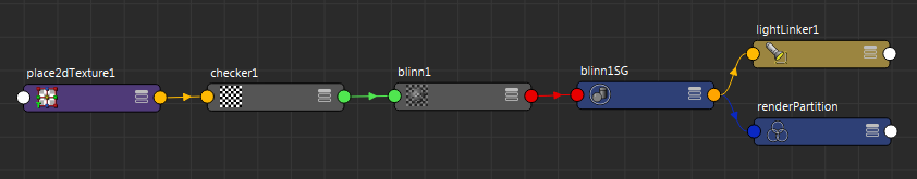

  2. Select the shading group node and click , your shader network is now graphed in the Node Editor.
