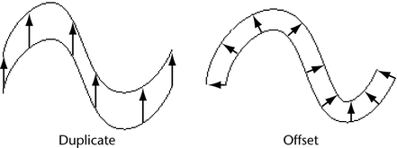

Creates a copy of a curve or surface that is offset from the original (every point on the copy is a specific distance from the corresponding point on the original).

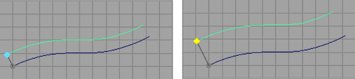

Create an offset copy of a curve
  1. Do one of the following:
    • Select a curve or isoparm, then choose Curves > Offset > Offset Curve.
    • Select a curve-on-surface, then choose Curves > Offset > Offset Curve On Surface.
  2. An offset curve is created at a default offset distance of 1.0.
  3. In the toolbox, click the Show Manipulator tool and use the manipulator to change the offset distance.

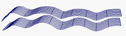

Create an offset copy of a surface
  1. Select the surface.
  2. Select Surfaces > Offset > .
  3. Do one of the following:
    • To preserve surface curvature, set Method to Surface Fit.
    • To preserve CV layout, set Method to CV Fit.
  4. Enter a distance to offset. You can change the distance interactively in the channel box or attribute editor after you offset.
  5. Click Offset.
