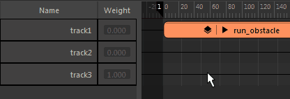

To create a Clip Layer:
Right-click a (or Shift-select multiple) clip in the Time Editor, and select
Create Additive
or
Create Override
from the
Time Editor toolbar or from the Layers area of the
Time Editor Clip contextual menu.
next to the name. Click this to expand the Layer view. See
Key on Clip Layers. The active clip is outlined in red to let you know which Clip Layer is ready to receive keys.

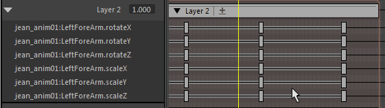

To set a key on a Clip Layer
Click the expanded Clip Layer, ensure that it appears in the
Time Editor toolbar Active Layer field to select it for keying (the active layer highlights in red), and select Set Key
, or press
S.
To move a key on a Clip Layer
Select the key and drag.
