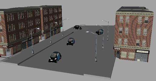

Consider a low polygon car referenced into a city scene, then scaled and animated.

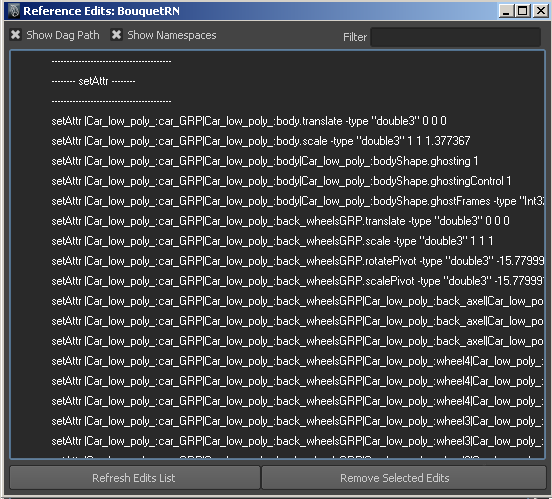

In its source file (Car_low_poly.ma), the car model is organized under an asset named Car_AST. The asset’s published attributes include the car’s Translate and Rotate values as well as the spin of its wheels and the left and right turn of its front wheels. In the parent scene, the animation is achieved by modifying these published attributes. These are called reference edits and are stored in the parent (City.mb) file.
You can view reference edits by selecting File > List Reference Edits from the Reference Editor.

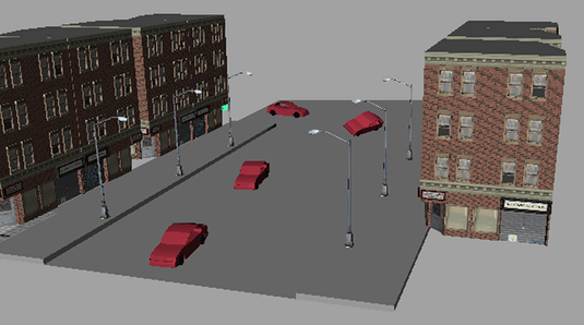

Now consider a second car model that you want to replace the old car model. This new car resides in its own file (Car_high_poly.ma).
The second model has a different structure and additional nodes compared to the original model for extra details such as the steering wheel, windows, side doors, and trunk.

You can now exchange the old car in the city scene by replacing the existing reference with a reference to the new car.
To replace the car being referenced by the city
  1. In the parent file, select File > Reference Editor.
    The Reference Editor appears.
  2. In the Reference Editor, select the car reference.
  3. Select Reference > Replace Reference.
    A file browser appears.
  4. Select the file for your new car (Car_high_poly.ma) and click Reference.
The old car is replaced with the new car with the appropriate scaling. If you playback the scene the new car also follows the old car’s animation.
