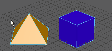

To snap objects together with interactive control
- Select .
- Click the point on the first object you want to snap.
- Click the point on the second object you want to snap to.
- An arrow appears showing how the objects snap together. To change the points, click or drag new points on either object.
- Press Enter to snap the objects together.
The Snap Together Tool normally moves and rotates the objects to make the points touch. Use the tool settings to make the tool move the objects without rotation.

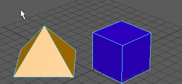

To snap two objects together at one point
- Select the point that will move.
- Shift-select the point to snap to.
- Select
Maya moves the first point’s object so the two points touch.
Tip: Switch to Vertex mode to choose the object's points.
