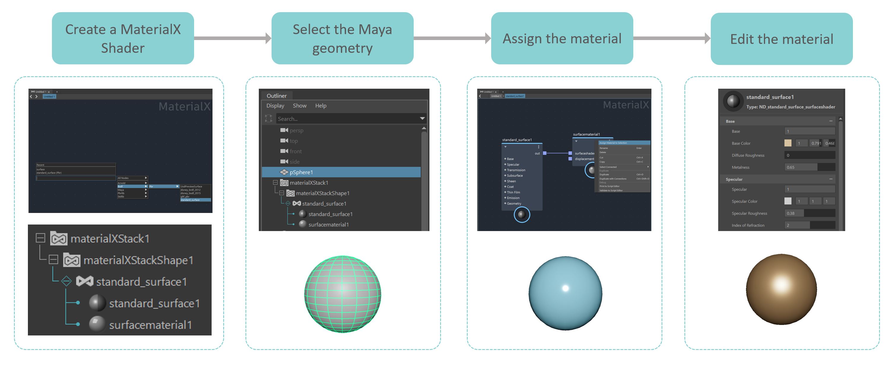

MaterialX data model supports surface, displacement and volume shaders. The following diagram describes a workflow for working with LookdevX using the MaterialX data model.
diagram for MaterialX workflow

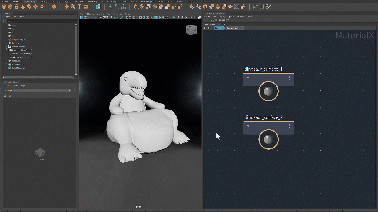

Assign new materials A material assignment menu is available in both the Outliner and Viewport. You can assign either surface or volume materials to your model.
gif for material assignment

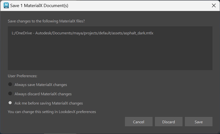

Several options are available for saving edits to loaded MaterialX documents when saving the Maya file. If a loaded MaterialX document has edits, and the Maya scene is saved, a window will appear.
image for Loaded MaterialX document
The options in the Save MaterialX Document dialog allow setting the desired behavior of what happens to edits when the Maya file is saved. If an option to not show the window is chosen, preferences can be changed in the LookdevX section of the Maya Preferences.
  • Always save MaterialX changes: Edits to loaded MaterialX documents are always saved and this options window will no longer appear when saving the Maya scene.
  • Always discard MaterialX changes: Edits to loaded MaterialX documents are always discarded and this options window will no longer appear when saving the Maya scene.
  • Ask me before saving MaterialX changes: This options window will always open to confirm the desired action to save or to discard changes to the loaded document.
If the preference to "Ask me before saving MaterialX changes" is selected, choose one of the following buttons to decide how to handle the edits in the loaded document:
  • Cancel: Closes the window without setting a preference, saving, or discarding changes. The Maya save scene action is also cancelled.
  • Discard: Discards any edits to the loaded MaterialX document, the Maya scene is saved.
  • Save: Saves any changes to the loaded MaterialX document, the Maya scene is saved.

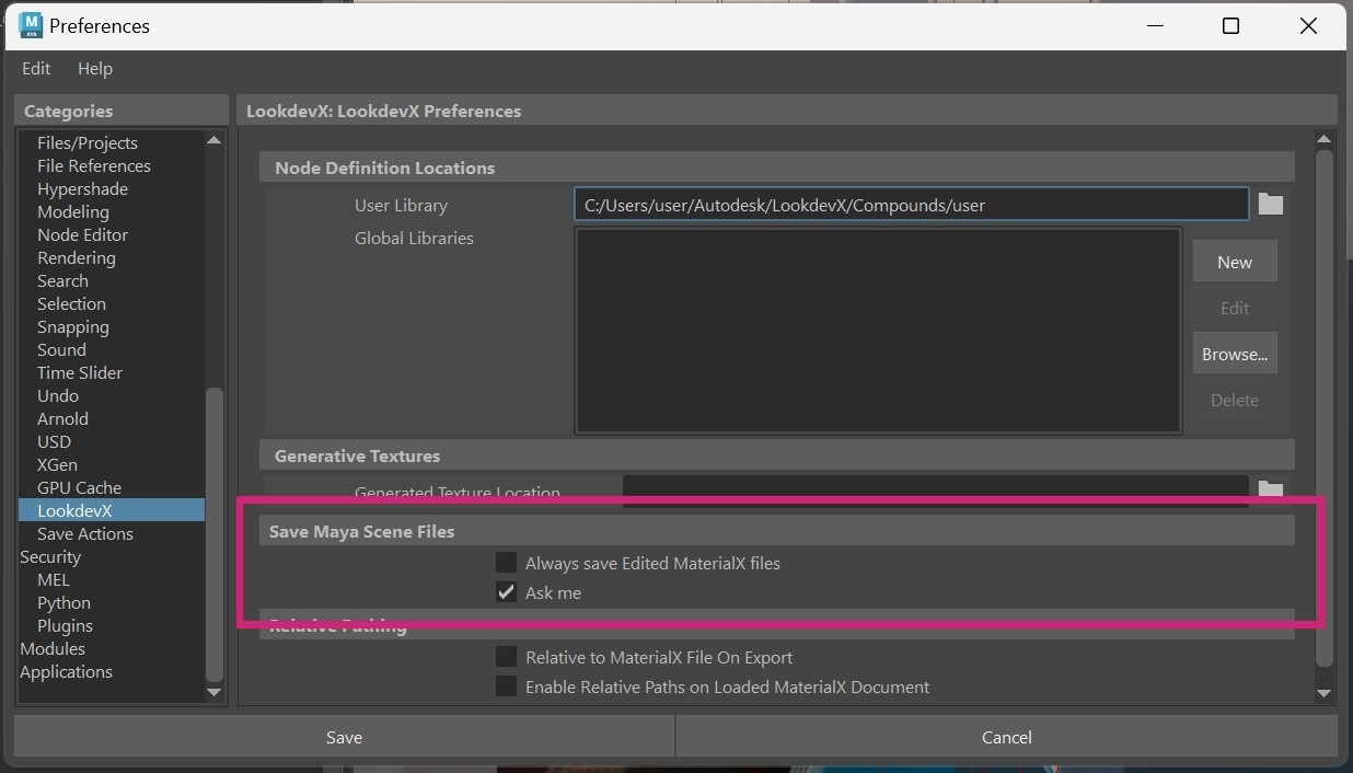

To access the preferences in the Preferences panel, choose the Windows menu, then choose Settings/Preferences, next choose LookdevX. Under the Save Maya Scene Files section of the preferences, two options are available:
  • Always save Edited MaterialX files: Edits to loaded MaterialX documents are always saved and this options window will no longer appear when saving the Maya scene.
  • Ask me: This options window will always open to confirm the desired action to save or to discard changes to the loaded document.
