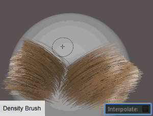

Paint Operation
Specific to the Density Brush. Updates the density of hairs in the brush radius as you drag across the surface of the mesh. The actual density values applied by the brush strokes is based on a combination of the Paint Operation and Value settings.
In a typical workflow, set the maximum value you want to achieve with the Value attribute, then adjust the Strength to decrease or increase the effect of the Paint Operation.
Hotkey: Pressing Ctrl toggles between Increase and Decrease. Press N to toggles between the Paint Operation settings
Set
Sets the density of hairs in the brush radius to the set Value. Remove hairs by setting theValue to 0.
Increase
Increases the density of hairs in the brush radius by the set Value.
Descrease
Decreases the density of hairs in the brush radius by the set Value.
Smooth
Blends the different density values of hairs in the brush radius by calculating an average density value.
Value
Specific to the Density Brush. The brush applies this value based on the set Paint Operation. The Value setting is multiplied by the Strength value before it is applied to the hairs.
Max Density
Specific to the Density Brush. Clamps the number of hairs per-face when the Paint Operation is set to Increase.

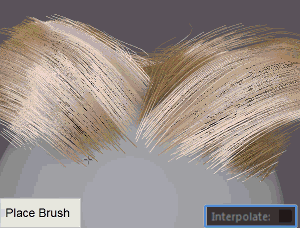

Remove
Specific to the Place Brush. When on, you can remove previously placed hairs by clicking them. The brush removes all placed hairs within its radius. This option is off by default.
Hotkey: Ctrl toggles between Add and Remove.
Tip: You can display the hairs added by the Place brush in a specified color to distinguish them from hairs added by another method, such as by the Density brush. To do this, turn on Highlight Placed Hairs in the Preview Settings section of the descriptionShape node attributes. See XGen interactive grooming description node attributes.
Clear All
Specific to the Place Brush. Removes all the hairs placed on the surface by the brush.
Interpolate
When on, the new hairs match the length and shape of the surrounding hairs. When off, the new hairs use the Initial Length value and have no defined shape (they follow the surface normal). The width of new hairs is 1.0 multiplied by the Width Scale value of the description node. Interpolate is off by default.
This option is not available when Paint Operation is set to Decrease.
