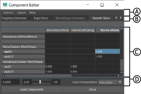

Component Editor: A. Component Editor menus, B. Component Editor tabs, C. Component Editor spreadsheet area, and D. Auto Normalization menu
- Polygons
Lists component data of polygonal vertices, including color or normal data in world space coordinates. If color or normal data are not shared at the vertex level, the column displays the word UnShared. These unshared values can be viewed and edited from the AdvPolygons tab.
- AdvPolygons
Lists vertex face component data, including color and normal values for the vertex face.
- Weighted Deformer
Lists component data of CVs, vertices, or lattice points influenced by cluster deformers (cluster weights).
- Rigid Skins
Lists component data of CVs, vertices, or lattice points bound to a skeleton’s joints by rigid skinning (joint cluster weights).
- BlendShape Deformers
Lists component data of CVs, vertices, or lattice points influenced by a target object.
- Smooth Skins
Lists component data of CVs, vertices, or lattice points bound to a skeleton’s joints by smooth skinning (skin cluster weights).
- Springs
Lists component data for springs, including stiffness and damping data.
- Particles
Lists component data for particles, including color or velocity data.
- Each component is a row, and each value or influence on the component is a column.
- Click, shift-click, or drag across a cell, column, or row to select it.
- Type a value to enter it in all selected cells.
| Value | Function |
| None |
Turns off smooth skin weight normalization. |
| Interactive | When on, Maya normalizes skin weight values as you add or remove influences, and as you paint skin weights. |
| Post |
Selecting this mode lets you paint or change weights without affecting the weights for other influences, and still have the skin normalization occur when you deform the mesh. |
Note: The
Auto Normalization menu shows no value if nothing is selected, or the selection does not involve a skinCluster node as the
Auto Normalization menu value is driven by skinCluster nodes.
For more information about these settings, see skinCluster and Set Normalization mode and normalize weights. |
