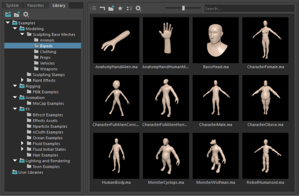

To load a sample scene
  1. Open the Content Browser and click the Examples tab.
  2. Open the folder of models you want, then drag and drop the model into the view panel.
