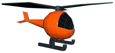

Polygon objects
Often called polygon meshes, polygon objects are 3D geometric objects made up of faces, edges, and vertices. Polygon meshes are widely used for many types of 3D models created for games, film, and internet.
See Polygonal Modeling for more information on what polygon meshes are, and all the ways in which you can create and edit them.

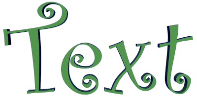

Text
Text is 3D text that you can create using the Type tool - choose Create > Type. This lets you create branding, flying logos, title sequences, and other projects that require text.
See Create polygon text for more information.

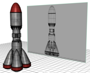

Image planes
Image planes are 2D planes (grids) onto which you can "project" different images, usually used for reference images as you model an object, or as a background image for your scene.
You can create either free images planes that are not attached to a camera (choose Create > Free Image Plane), or attached to a perspective camera (choose View > Image Plane > Import Image in a perspective view panel).
See Image planes for more information.

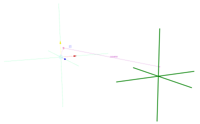

Locators
Sometimes called nulls, locators are icon-like objects that only represent a position in space, and aren't rendered - choose Create > Locator.
Although locators don't sound like much, they are useful helper objects, such as for being a parent for character joints, objects to which you can constrain another object, or measuring distance between two points.
