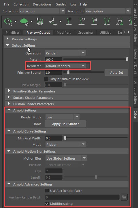

Arnold Output Settings
To show the Arnold output settings:
  1. In the XGen Editor, go to the Preview/Output tab.
  2. In the Output Settings section, select Arnold Renderer in the Renderer list.
Arnold Settings
Render Mode
Live allows XGen to query patches and guide animation directly from Maya. This does not support Motion Blur and will try to reuse information the preview generated.
Batch Render mode will always read geometry and animation from files. Batch render mode is always on when doing a batch render. You must first export the patches and guide animation to caches. Use this mode to make sure your caches are properly exported before doing a batch render.
Tools
Apply default Arnold XGen Hair Shader to the current Description. The shader reacts to root_color, tip_color, and back_color XGen custom shader parameters.
Arnold Curve Settings
Min Pixel Width- Arnold's minimum pixel width for curves. More information here.

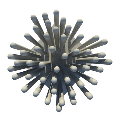

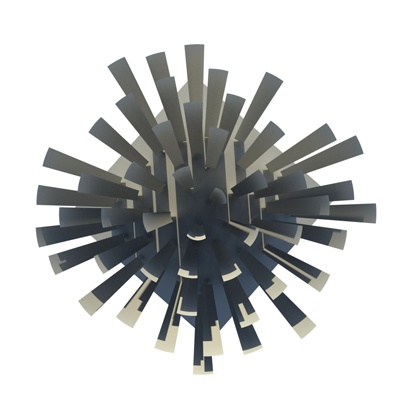

Mode- Curve Primitives can be rendered as ribbon or thick. To get 'oriented' facing splines that do not face the camera, you must disable Face Camera in the XGen Primitives tab.
Arnold Motion Blur Settings
Choose between Global Settings (uses the MtoA motion blur Render Settings), On or Off.

Arnold Advanced Settings
When using export patches for batch rendering, XGen will create an .abc file that is stored in the same folder as the scene. Use Aux Render Patch enables you to explicitly choose the file that you want to use, for example, a previously exported .abc file.
Enable/disable Auxiliary Render Patch.
File path used for the exported .abc file.

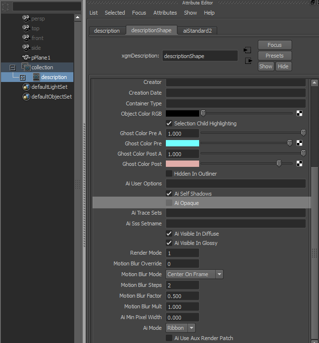

Spline Opacity
To change the Opacity of XGen splines, you must first select the XGen description and then disable Ai Opaque within the Extra Attributes of the Attribute Editor.

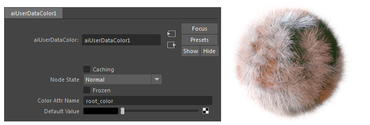

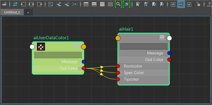

To obtain color information from XGen splines, such as those found in the XGen Presets, you will need to add the following steps.
  • A scene that demonstrates this process can be downloaded here.

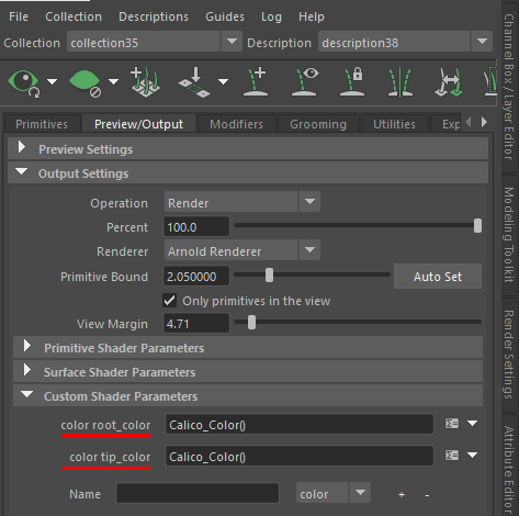

  1. Go to the XGen window (Preview/Output tab) and make a note of the custom shader parameter names.
  1. Assign a shader to the XGen description.
  2. Connect an aiUserDataColor shader to the color attribute of the shader that you want to use (e.g. root color).
aiUserDataColor shader connected to standard_hair attributes
  1. Add the name of the attribute to the Color Attr Name attribute of the aiUserDataColor shader. In this case it is 'root_color'.
XGen hair color rendered using aiUserDataColor

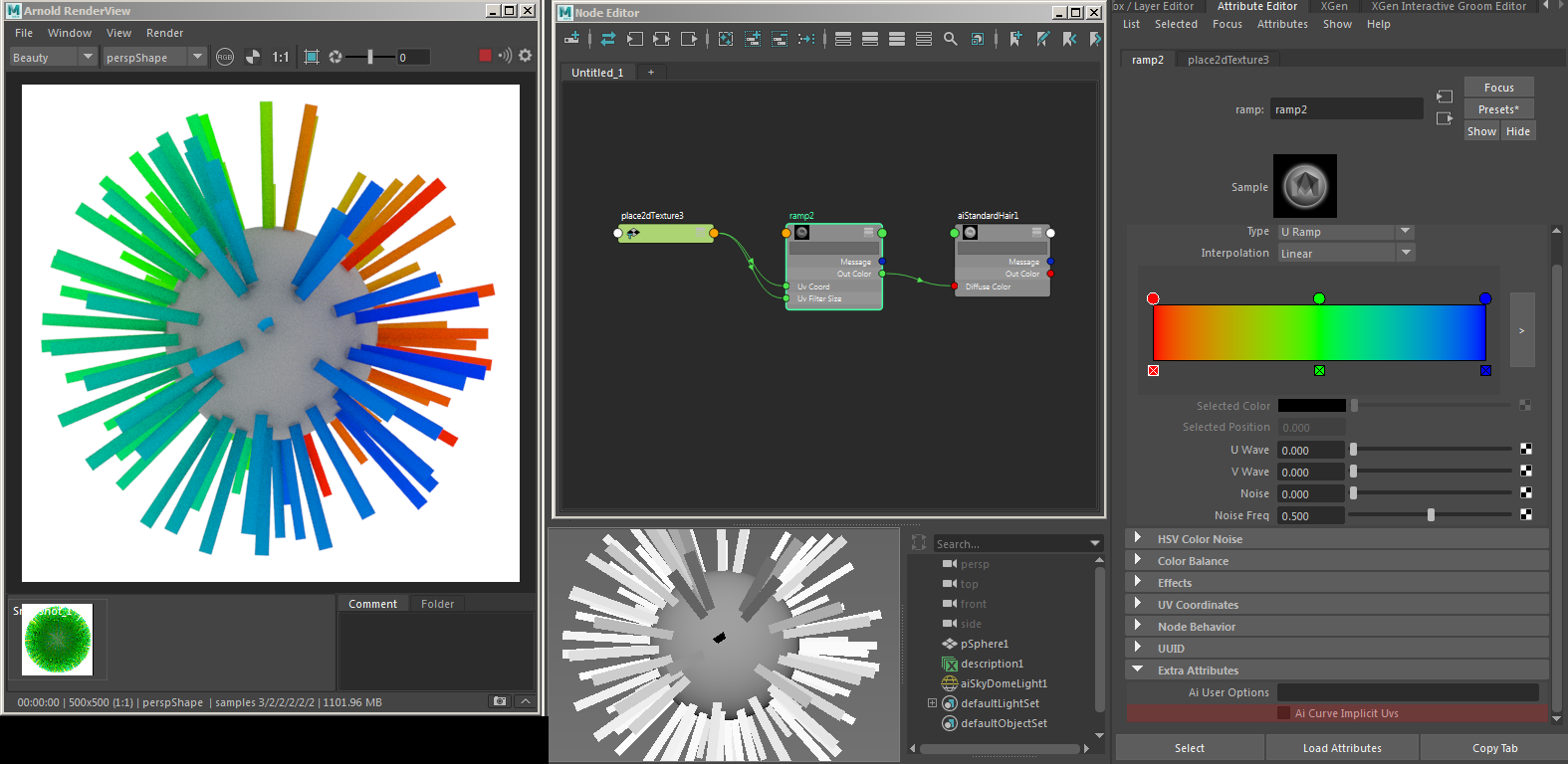

Curve Implicit UVs
Implicit UVs on curves (root-to-tip) can be enabled in the Ramp's Extra attributes.
When disabling CurveImplicit UVs the ramp will be applied over the real UV coordinates

UVs are supported in "XGen splines". This is an XGen shape (available in Maya 2017), found under Generate->Create interactive groom splines.
