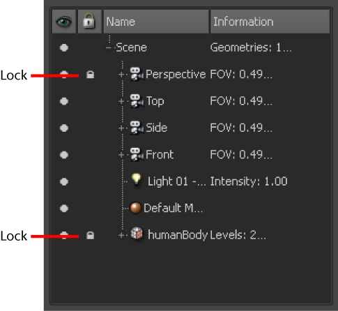

To lock or unlock a model
- Do either of the following:
- Right-click the model and select Lock/Unlock Model from the marking menu.
- Select the model you want to lock in the Object List, and click the Lock icon. (Click the lock icon again to unlock the item.)
