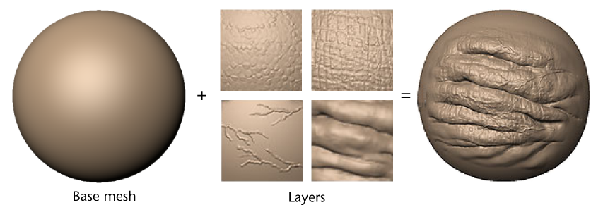

Sculpt layers let you organize your sculpting and combine forms and details in a non-destructive manner. You can create a layer and then sculpt so that only the new details appear on the new layer. To modify your sculpting on that layer you can either perform additional sculpting or remove the layer without affecting details on the base mesh. Sculpt layers combine in an additive manner. They behave much like layer systems in 2D image editing applications such as Photoshop®, but record 3D sculpting information.

Sculpt on one region of a mesh without affecting other areas. You can create a sculpt layer then sculpt on it so the new details are separate from the original mesh. If you need to modify your sculpting on that layer you can either perform additional sculpting on that layer, change the transparency for the layer, mask regions of it temporarily, or remove it without affecting details on other layers or on the base mesh. In this way, you can combine forms and details in a non-destructive manner. Using layers in this way lets you easily adapt to changes in art direction or explore different design iterations.

When sculpting on a layer, Mudbox calculates the difference between the position of vertices after a tool stroke and their original position on the base mesh. Only the difference in position (the delta) is stored on the layer. This delta is added to the base mesh and to the deltas stored in all the other layers to arrive at the final shape of the model. Because the sculpt layers combine in an additive manner, the order of layers is not important to the final result.
