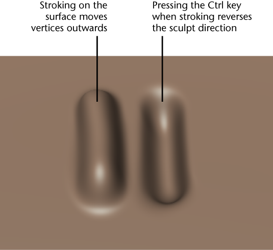

  3. Click-drag the tool cursor across the surface of the model.
    The vertices on the model move slightly outwards along the path you dragged. This path is called a stroke. A stroke appears continuous but is actually made up of many stamp impressions that overlap each other. You can adjust how much the stamps overlap by adjusting the Stamp Spacing .
    Note: Not all sculpt tools move vertices outwards by default.
  4. To reverse the sculpt direction for any sculpt tool, the cursor across the surface of the model.
