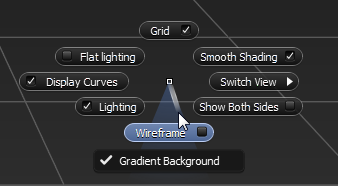

Display marking menu
Right-click an empty area of the scene for quick access to these marking menu options.
Grid
Toggles the display of the grid in the 3D View.
Smooth Shading
Displays models in the 3D View as smooth shaded objects. On by default.
Switch View
Lets you quickly switch between Perspective, Top, Side, and Front camera views, or from any custom camera bookmarks you create. See also Switch camera views.
Show Both Sides
Displays both sides of a model. This is evident when you tumble a model with an open edge and view its interior.
Wireframe
Displays smooth shaded models in the 3D View with a wireframe representation of the model simultaneously. Wireframe displays the lowest subdivision level and the current subdivision level simultaneously. For more information on setting wireframe display options, see Limit Wireframe to Level in the Render preferences.
Lighting
Toggles the display of lighting that illuminates models in the 3D View. Turn off lighting to view models as black silhouettes. (Hotkey: Ctrl + L)
Gradient Background
Toggles the display of the gradient background in the 3D View.
Flat Lighting
Displays models in the 3D View without lighting and shading. Only the RGB values of the assigned material or texture appear.
