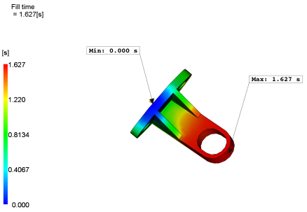

Minimum and maximum result values
When interpreting the results, it is often valuable to identify the extreme values of the results and their location. The Show Min/Max tool locates the maximum and minimum data points on the geometry, and labels them with the result value.
  • Show Min/Max
This feature supports the following mesh types:
  • 3D mesh 3D
Note: Show Min/Max does not support some result types. In addition, it is not supported for results that contain 1D beam elements, for example in runner systems. Place the runner system on a separate layer and hide it to enable Show Min/Max.
