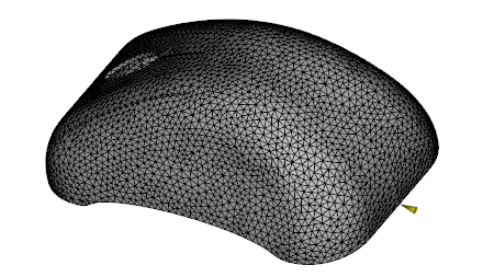

(Home tab > Import panel > Import).Navigate to the location where you saved the tutorial file.
Select the file mousecover_meshed.sdy and click Open.
