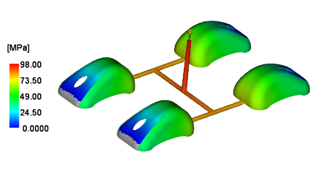

Select Pressure at V/P switchover in the study tasks list.
Click
(Results tab > Animation > Play).Rotate, pan, and zoom as necessary to see the result.
The pressure at V/P switch-over is best when under 75% of the machine capacity. For a typical machine with a capacity of 140 MPa or about 20,000 psi, the pressure is acceptable when under 100 MPa or about 14,500 psi.
The maximum pressure is about 100 MPa, decreasing the V/P switch-over pressure is advantageous.

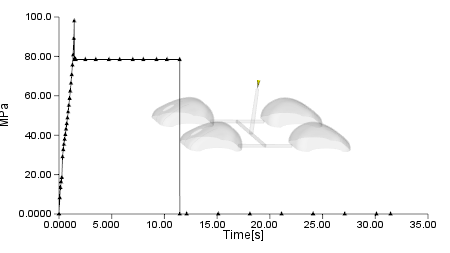

Click Pressure at injection location:XY Plot.
Here you can see how the pressure builds up and drops 20% for the packing phase. This is the default packing profile.
