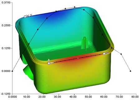

In the following figure, one edge of the part has a path plot on it to see how much the edge moves in the Y-direction. The first and last nodes selected for the path plot are first two nodes used to define the anchor plane. The deflections at the anchor nodes are zero, making the path plot easier to interpret.
Figure 1 Path plot of the Y-Deflection
